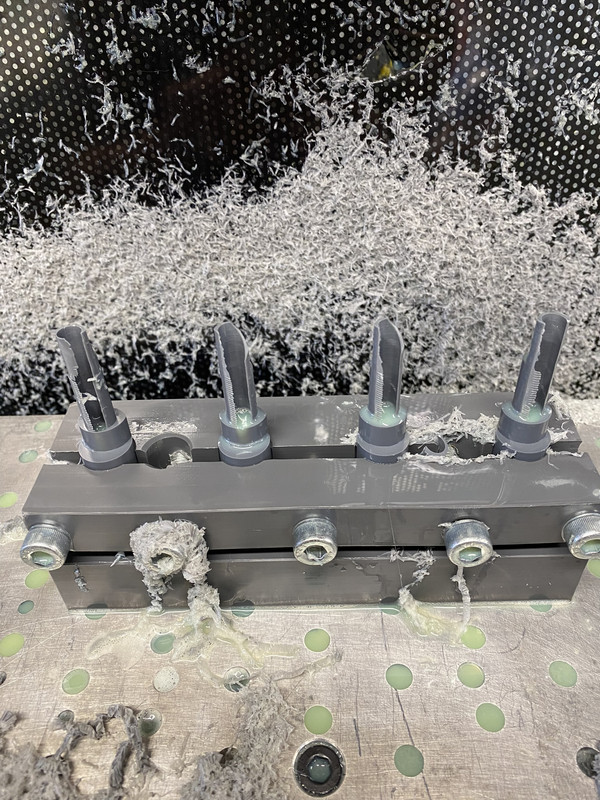

In a nutshell, when I'm running a program, the mill is losing position in the Y axis only. I have a series of parts I make, and have noticed the issue on two programs for sister parts (I haven't tried to reproduce on other programs yet).
The program is essentially a series of bores (Mainly OD). I'm holding 4 parts in fixture, lined up along the X axis.

- The loss always happens between operations (i.e. first series of bore ops is in position, second is offset). It never loses position during the boring, and is never different between parts.
- It follows a pattern, but isn't always in the same place. e.g. it might start misbehaving on bore 2 or bore 3. Always at the start of an op, but not always the same op.

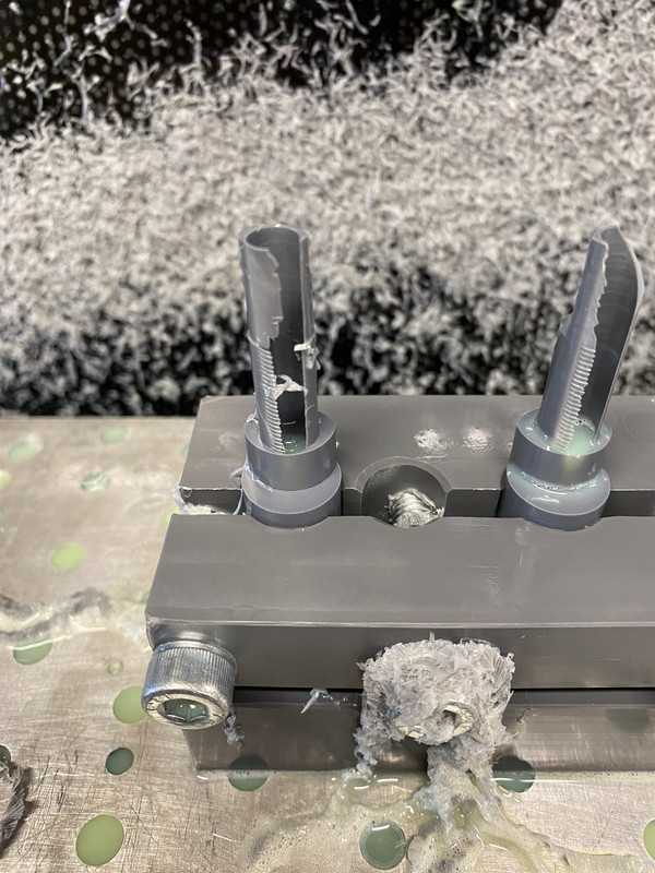

- Photo's of the problem here. As you can see, it has cut the original bore on position, and then the next cut is offset in Y.

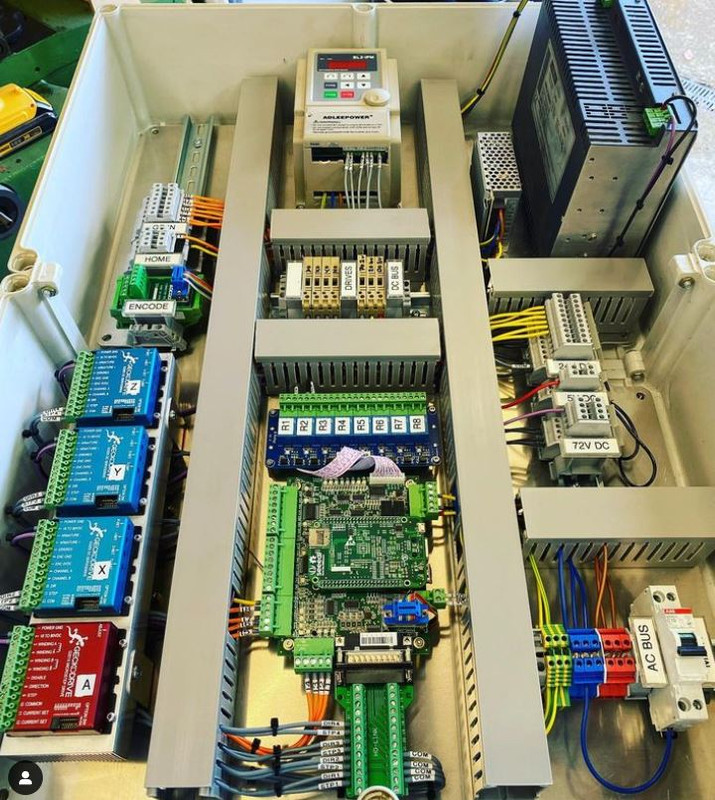

- Cabinet wiring is reasonably tidy (photo attached, note that the 24V/5V supply was actually swapped out to a larger one after the picture was taken)

- On a cabinet note, I while writing this I have realised that I am using the 24V/5V power supply for everything control, which looks like a violation of Tech bulletin 270, point 5.
- As per above, I've also not fitted snubbers to the relays in the coolant management cabinet (although I believe they are built into the units), or the coolant solenoid coils. I do note that no relays cycle anywhere near the points in the program where the issue arises.

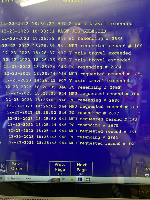

- Reviewing the error log, I see a number of 944/946 MPU resend requests. That said, they DO NOT line up with the issue.

MPU resend and PC resending issues must be resolved before any other problems can be worked on. The control system will not work properly with these errors occuring. They are usually easy to fix.
Run the PC tuner on this CNCPC. latest version is v1.2.2
https://www.centroidcnc.com/centroid_di ... _1.2.2.zip
run the com stress test. (i see you are running v4.64 this is a pretty old version of CNC12 software. (there have been about 1000 changes in cnc12 since then ) i would seriously consider installing and configuring the latest version v5.08 (its free) download here. https://www.centroidcnc.com/centroid_di ... loads.html
the com stress test does not exist in v4.64 since it was invented afterwards.

Turning the machine on and jogging around, I was able to create a few COM's errors in the log, confirming that the machine was in a misbehaving state on this power up.
I followed through the instructions in the posts & links above, and noted that I had WiFi on, so turned this off as it's not needed. I also had the Ethernet "Allow the computer to turn this device off.." incorrectly set, and additionally still had Microsoft One Drive installed so remedied that. I also changed the Ethernet to 100MBs and Half Duplex at the same time.
Running the machine gave pretty much continuous "PC Requested Resend" errors at this point, so I went back and changed just the Ethernet setting back to the original, and this cleared up all COM's errors in the log - good result! I jogged the machine around and could not create any COM's errors in the log.
I then ran a program, and got another position loss - not so good. Interestingly though, it lost position in the opposite direction which I have never seen before, suggesting that something I had changed was indeed having an effect on things.
Now the COM's issue seems to be sorted, I went ahead and installed and configured v5.06. I ran the stress test and it returned no errors, so went ahead and ran the program again, which worked perfectly first time! I'll need to run the machine for an extended period to confirm good (it's a 1 hour program, so my Sunday morning interest in watching parts being made was limited), but fingers crossed the issue is indeed resolved!
